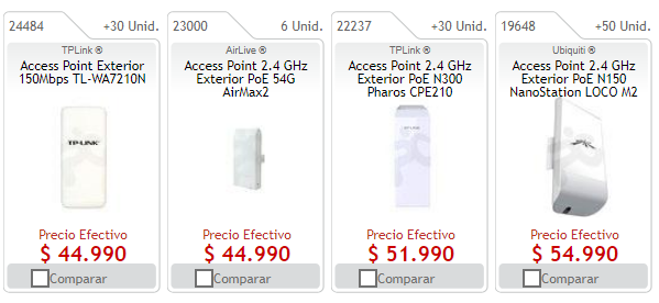

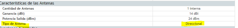

Ver adjunto 2003
Eso responde tu comentario
Paginas 7 del propio manual dicen lo contrario
"1.6.6 AP Router Mode In AP Router Mode, the AirMax5X behaves like a wireless router. The non-PoE port of the AirMax5X will become WAN port. Both the wireless and the passive PoE port of AirMax5X becomes the LAN side. User can manage the AirMax5X through the wireless or passive PoE port. And if the remote management is opened, user can also get to manage AirMax5X via the WAN side. "
