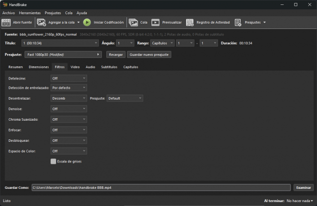

hice una prueba con el video de BBB en un i7 9700 que es compatible con tu placa

HandBrake 1.10.2 (2025090600)
OS: Microsoft Windows NT 10.0.26100.0
CPU: Intel(R) Core(TM) i7-9700 CPU @ 3.00GHz
Ram: 65465 MB,
GPU Information:
AMD Radeon RX 5700 XT - 32.0.12033.1030
Screen: 2560x1440
Temp Dir: C:\Users\Marcelo\AppData\Local\Temp\
Install Dir: C:\Program Files\HandBrake\
Data Dir: C:\Users\Marcelo\AppData\Roaming\HandBrake
# Starting Encode ...
[14:03:53] base preset: Fast 1080p30 (Modified)
[14:03:53] Remote Process started with Process ID: 19248 using port: 8037. Max Allowed Instances: 1
[14:03:54] Worker: Starting HandBrake Engine ...

[14:03:56] + name: Stereo
[14:03:56] + decoder: Unknown (AC3, 5.1 ch, 320 kbps) (track 2, id 0x2)
[14:03:56] + bitrate: 320 kbps, samplerate: 48000 Hz
[14:03:56] + mixdown: Stereo
[14:03:56] + encoder: AAC (libavcodec)
[14:03:56] + bitrate: 160 kbps, samplerate: 48000 Hz
[14:03:56] sync: expecting 38073 video frames
x265 [info]: HEVC encoder version 4.1+190-c8ceb6b
x265 [info]: build info [Windows][GCC 13.2.0][64 bit] 8bit+10bit+12bit
x265 [info]: using cpu capabilities: MMX2 SSE2Fast LZCNT SSSE3 SSE4.2 AVX FMA3 BMI2 AVX2
x265 [info]: Main profile, Level-4 (Main tier)
x265 [info]: Thread pool created using 8 threads
x265 [info]: Slices : 1
x265 [info]: frame threads / pool features : 3 / wpp(17 rows)
x265 [info]: Coding QT: max CU size, min CU size : 64 / 8
x265 [info]: Residual QT: max TU size, max depth : 32 / 1 inter / 1 intra
x265 [info]: ME / range / subpel / merge : star / 57 / 3 / 3
x265 [info]: Keyframe min / max / scenecut / bias : 30 / 300 / 40 / 5.00
x265 [info]: Lookahead / bframes / badapt : 25 / 4 / 2
x265 [info]: b-pyramid / weightp / weightb : 1 / 1 / 0
x265 [info]: References / ref-limit cu / depth : 4 / on / on
x265 [info]: AQ: mode / str / qg-size / cu-tree : 2 / 1.0 / 32 / 1
x265 [info]: Rate Control / qCompress : CRF-20.0 / 0.60
x265 [info]: tools: rect limit-modes rd=4 psy-rd=2.00 rdoq=2 psy-rdoq=1.00
x265 [info]: tools: rskip mode=1 signhide tmvp strong-intra-smoothing lslices=4
x265 [info]: tools: deblock sao
[14:03:57] sync: first pts video is 0
[14:03:57] sync: "Captulo 1" (1) at frame 3 time 3000
[14:03:57] sync: first pts audio 0x2 is 0
[14:32:45] reader: done. 1 scr changes
[14:32:50] work: average encoding speed for job is 21.981911 fps
[14:32:50] comb detect: heavy 1468 | light 4019 | uncombed 32587 | total 38074
[14:32:50] decomb: deinterlaced 1468 | blended 4019 | unfiltered 32587 | total 38074
[14:32:50] vfr: 19038 frames output, 19036 dropped and 0 duped for CFR/PFR
[14:32:50] vfr: lost time: 0 (0 frames)
[14:32:50] vfr: gained time: 0 (0 frames) (0 not accounted for)
[14:32:50] ac3-decoder done: 19817 frames, 0 decoder errors
[14:32:50] h264-decoder done: 38072 frames, 0 decoder errors
[14:32:50] sync: got 38074 frames, 38073 expected
[14:32:50] sync: framerate min 60.000 fps, max 60.000 fps, avg 60.000 fps
x265 [info]: frame I: 159, Avg QP:16.45 kb/s: 53309.10
x265 [info]: frame P: 5422, Avg QP:20.43 kb/s: 10330.74
x265 [info]: frame B: 13457, Avg QP:26.99 kb/s: 1164.60
x265 [info]: Weighted P-Frames: Y:4.0% UV:2.6%
encoded 19038 frames in 1734.06s (10.98 fps), 4210.60 kb/s, Avg QP:25.03
[14:32:50] mux: track 0, 19038 frames, 334081896 bytes, 4211.34 kbps, fifo 2048
[14:32:50] mux: track 1, 29726 frames, 12869389 bytes, 162.23 kbps, fifo 2048
[14:32:50] Finished work at: Tue Sep 30 14:32:50 2025
[14:32:51] libhb: work result = 0
# Job Completed!
