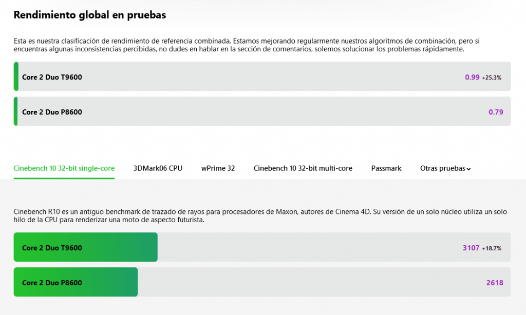

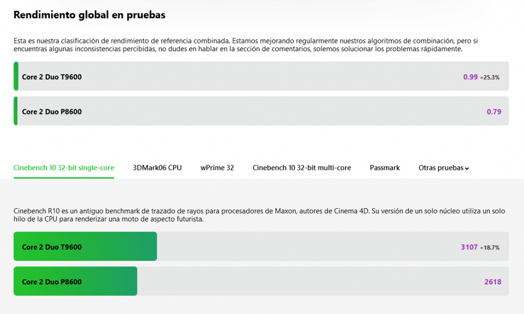

Pantalla ancha LED HD de 14" retroiluminada (16:9)
(WxDxH): 13.4" x 9.13" x 0.68" - 1.35", 340.0mm x 231.8mm x 17.2 - 34.4mm
2.0-megapixel
2.0-megapixel
